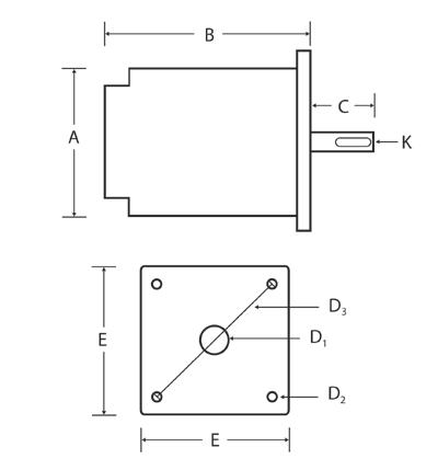

CENTROID Servo Motor Dimensions
Motor |
A |
B |
C |
D1 |
D2 |
E |
K |
D3 |
| 7 in-lb DC nema 23 | 1.97" |
5.021" |
1.185" |
.25" |
.15" |
2.270" |
2 flats |
2.625" |
| 10 in-lb DC nema 34 | 2.75" |
5.437" |
1.063 |
.375" |
.218" |
3.25" |
1/8" |
3.875" |
16 in-lb DC Part # |
3.500" |
8.120" |
1.5" |
11.0mm |
0.280" |
3.530" |
4.0mm |
3.937" |
29 in-lb DC G Part #4675 |
4" |
9.003" |
1.898" |
0.625" |
0.281" |
4.250" |
0.1875" |
4.950" |
29 in-lb DC Sem Part #10104 |
4" |
9.738" |
2.050" |
0.625" |
0.266" |
4.250" |
0.1875" |
4.950" |
40 in-lb DC Sem Part #10113 |
4" |
11.498" |
2.050" |
0.625" |
0.266" |
4.250" |
0.1875" |
4.950" |
40 in-lb DC Sem w/brk Part #10065 |
4" |
13.268" |
2.050" |
0.625" |
0.266" |
4.250" |
0.1875" |
4.950" |
750W AC Part #10690 |
85.0mm |
185.0mm |
30.0mm |
16.0mm |
7mm |
85.0mm |
5.0mm |
100.0mm |
1kW AC Sem Part #10555 |
130.0mm |
234.0mm |
40.0mm |
19.0mm |
9mm |
130.0mm |
5.0mm |
145.0mm |
1kW AC Sem w/brk Part #10615 |
130.0mm |
276.0mm |
40.0mm |
19.0mm |
9mm |
130.0mm |
5.0mm |
145.0mm |
2kW AC Sem Part #10557 |
130.0mm |
276.0mm |
40.0mm |
22.0mm |
9mm |
130.0mm |
6.0mm |
145.0mm |
2kW AC Sem w/brk Part #10716 |
130.0mm |
318.0mm |
40.0mm |
22.0mm |
9mm |
130.0mm |
6.0mm |
145.0mm |
3kW AC Sem Part #10715 |
120.0mm |
262mm |
54.50mm |
32.011mm |
11mm |
155.0mm |
10mm |
165mm |
