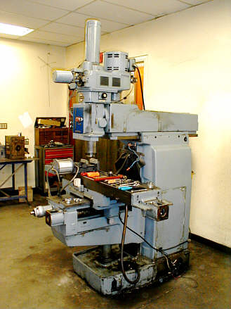

Shizuoka AN-S with the old original Bandit control.
This example of how a typical retrofit is installed was taken about 10 years ago, even though it is showing an older model being installed, the steps in the process are the same so we have left it up here on the website for your information.
Here is a Shizuoka model AN-S 3 axis NC mill. This rugged and very popular knee mill was originally equipped with a Bandit control. This machine is in good mechanical condition but is equipped with an old obsolete NC control.
With control parts becoming scarce and repairs more frequent, it was time to upgrade!

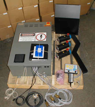

The M-39 is a lower cost Centroid package, you supply the monitor and standard PC keyboard. Centroid supplies the axis motors, amplifiers and CNC PC, and the prewired NEMA cabinet. There is also an optional hand-held push button pendant.

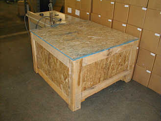

M-39 arrives fully assembled ready to install.
This is what you can expect when your control arrives. Centroid controls are not just a few computer parts in a UPS package.
Centroid CNC Controls are completely factory assembled and come ready to install on your machine.
Upacked M-39, notice all the prewired accessories and motor cables
The electrical enclosure of the M-39 is: 24" wide X 36" tall.
The axis motors are pre-wired with MS type plugs or can be hard wired.
CNC manual, hook up wiring diagram, and training video.
Optional hand-held M-39 control pendant.
Mounting hardware for monitor/ keyboard shelf.
Everything you will need,
right down to the nuts & bolts.
Remove the old control, unbolt the motors and the old control box.
The first step was to remove the old
control and motors.
Time: 1 hour
Keep all the hardware, you will be reusing it!

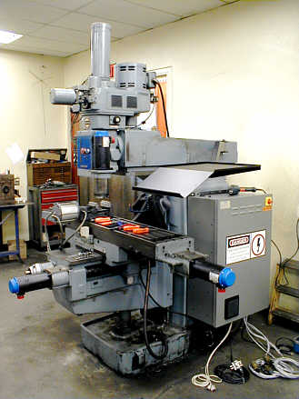

Just plug in the motors, monitor and keyboard.
We also wire in the machine limit switches, secure the cables, and wire tie any bundles for a first rate installation.
completed retrofit!  This machine is going back to work.
At this point we will enter a couple of values for each axis and then one button will auto-tune each axis servo driver. Our installation includes checking your machine's accuracy, setting the backlash values, and training your machinist to use this new tool.
Optional features such as TT-1 auto tool length measurement or network communications can be added now or in the future.
Time: 4.5 hours
Total time for install on this Shizuoka model AN-S knee mill retrofit is 8 to 10 hours.
