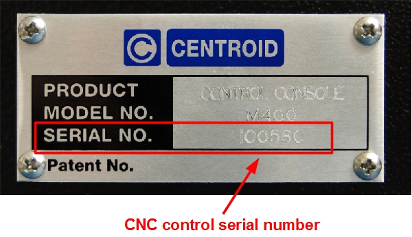

There are a few methods that can be used to identify your Centroid control. The quickest way is using the serial tag, which can be located on your remote handheld jog pendant, console, or electrical enclosure.
The serial tag is located either on the right-hand side or on the back of the console or on the back of the remote handheld jog pendant and it will look like the following:

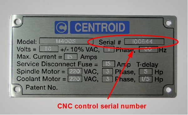

The serial number is also located on a tag which is located on the large electrical enclosure and will look like the following:

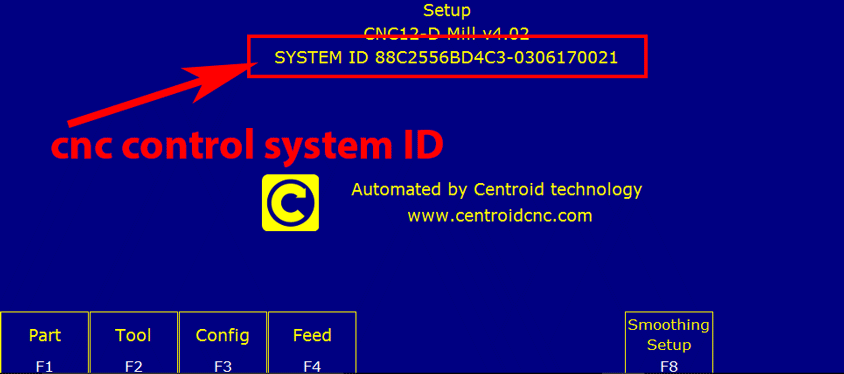

- The CNC control system ID is displayed on the main screen upon boot up and before homing.
- After homing you can find the cnc control system ID under the "F1" Setup screen

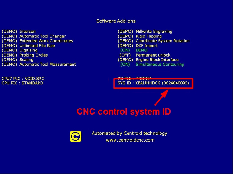

- On older systems, If the system ID in not in the F1 setup menu then it can be found in the Utilty Menu under options.
To get to the options menu, from the main screen press F7-Util then F8-Options. You will be able to locate your system ID near the center of the screen on the right-hand side, as shown below:
After homing system id can be found in the setup menu:
