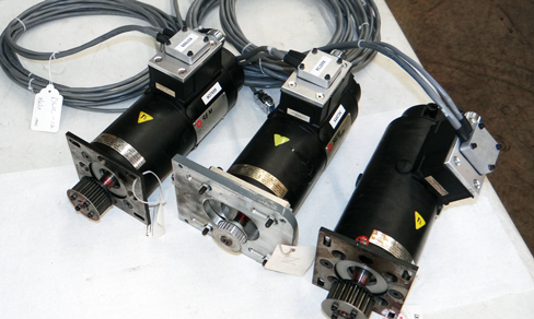

Step by step pictorial guide to installing a new Rotary Encoder and direct wire power and encoder cable on a 20 year old DC servo motor for use with a new Centroid CNC control
SEM DC Servo Motor Rotary Encoder Installation Retrofit Upgrade
Before upgrade...
After new encoder, cable and strain relief has been installed, motor is ready to mount back on the machine and run.
With thousands of DC servo motor based CNC machine tools worldwide, when it comes time to upgrade the original CNC control with a modern Centroid CNC, significant savings can be realized if the existing DC servo motors can be reused. This can often be accomplished by installing a new rotary encoder on the existing servo motors.
Over the last 30 years there have been a wide variety of makes and models of DC servo motors used on a wide variety of CNC machine tools. Many of these motors can return many more years of reliable service on the machine tool with an encoder upgrade. While each make and model of DC servo motor is a little different in design, the process of installing a modern high resolution encoder is often very similar from motor to motor. It is also common at the same time as the new encoder upgrade to install new servo motor power and encoder cables.
On this page we'll show you how we updated a typical 20 year old SEM DC servo motor for use with a new Centroid CNC control. This motor was originally equipped with a low resolution encoder and a tachometer for feedback to the original DC Servo Drive. We will be installing a new 10,000 line (40,000 counts per rev) encoder and new power and encoder cables with strain relief. (Note: No tachometer feedback is required with a Centroid DC Servo Drive so the tach will not be used.)

Download DXF drawing of SEM DC Servo Motor electrical box cover plate.
Make your own cover plate out of .25" thick aluminum. This plate replaces the cover plate that the stock mil (canon) connectors bolted to and accepts the Centroid Motor/Encoder cable seal and strain relief for easy direct wiring of the servo motor.
Download DXF SEM DC Motor cover adapter plate

Encoder Installation time for these SEM DC servo motors including the new power and encoder cable was 1.5 hours per motor.
Machining the Aluminum cover plates took about 6 minutes per plate once the Intercon program was finished and the tools were set up in the machine. Total time about an hour with deburing and cleanup.
