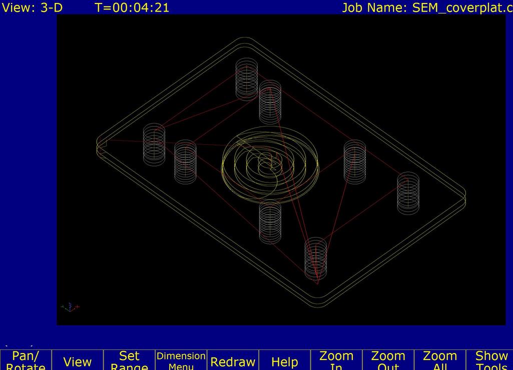

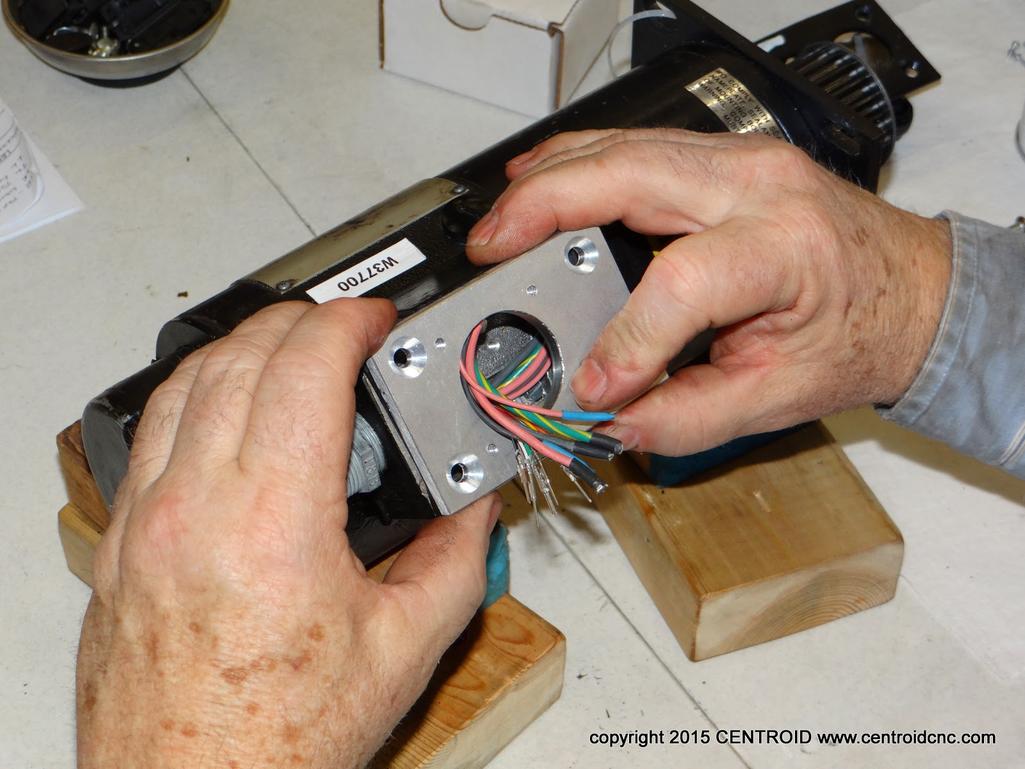

8.) How big of a G-code program can i run with the Free version of CNC12 software?
Answer: 50Kb. To give you an idea of what can be done with the Free version of the Acorn CNC12 software: on our website is a part program for a SEM DC servo motor cover plate, below on the left is the plate being installed and on the right is the tool path that was used to make the cover plate. This G code program to make this part is 5Kb in size.
Cover Plate
click image for larger view
Tool Path for Cover Plate
This is pretty typical of a home hobby shop type part. The G code file generated by a cad cam system or in this case Centroid's Intercon conversational programming software (with comments!) to make this part the G-code program is only 5kb in size. The Centroid FREE version of CNC12 has a file size limitation of 50KB so you could run a G code program 10 times this size with the Free version of CNC12. As you can see, you can do a lot even with the Free version of the Acorn CNC12 software.
Note: The Centroid PRO version of CNC12 has no file size limitation so you could run a file as large as the hard drive on the CNCPC and the Ultimate License also has no file size limitation. (only limited by the size of the CNCPC hard drive space)
