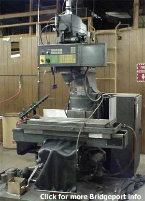

Here is an old Boss 10 just waiting to be retrofitted!
It is most economical to retrofit a machine that is currently a NC or CNC because of the fact that the ballscrews and axis motor mounts are already in place.

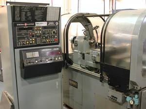

These two machines are great examples, both the Bridgeport Boss 10 and the Hardinge CHNC shown here on the left are very well built machines the mechanical condition of both is excellent, BUT the controls are dead! and they were never that good to being with. For much less than the cost of buying a new machine with equivalent quality and rigidity you can install a CENTROID CNC Retrofit kit that will replace all of the old outdated electronics and put that machine back to work!
It is interesting to note that often high quality ground screws are found on the old machines, (an expensive option on modern machines). Also, just as important as a good quality ballscrews are the ballscrew support bearings. Older NC machines often used the highest quality matched set angular contact support bearings.
