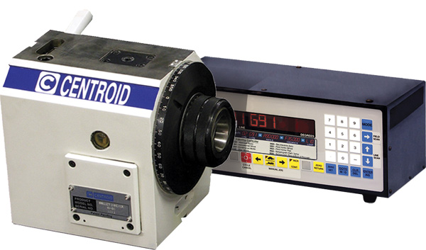

Rotary Table CNC Indexer Packages for use on any CNC or Manual Machine Tool
5C collet Rotary Indexer with DX1   $5,750 w/DC Servo motor.
5C collet Rotary Indexer package.
  • Uses Standard 5C Collet
  • Size up to 1-1/8" ID
  • Manual Collet Closer
  • Threaded Spindle Nose.
  • Runs on 110 VAC
  • Standalone or connect to your control.
  • Command from you CNC with M codes
  • Optional tail stock ATS-1

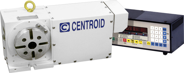

100 mm Rotary Indexer with DX1   $8,025 w/AC servo motor
100 Rotary Table Indexer package.
  • 120 mm / 4.72" Diameter face
  • Auto Home Switch
  • Auto pneumatic brake
  • Runs on single phase 220 VAC
  • Optional Manual Chuck SC-4*
  • Opt. Adapter plate AP-1 (included with chuck)
  • Optional Tail Stock
click on images for larger view.

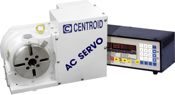

150 mm Rotary Indexer with DX1   $8,995 w/AC servo motor
150 mm Rotary Table Indexer package.
  • 150 mm / 5.9" Diameter face
  • Auto Home Switch
  • Optional Manual Chuck SC/SK-6*
  • Opt. adapter plate AP-1 (included with chuck)
