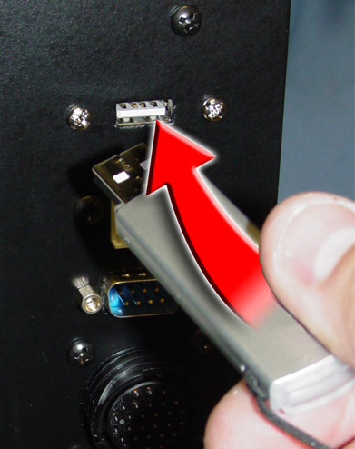

    Free USB 2.0 Port allows you to transfer DXF in and out of the control quickly and easily.

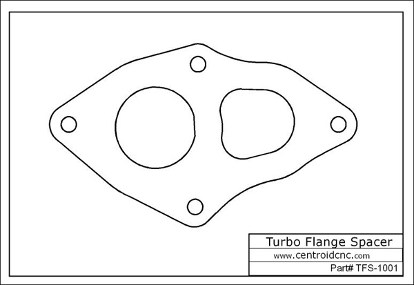

    Step #1
    Import DXF file into the control with the supplied USB port, the Floppy Disk or the ethernet LAN connection.

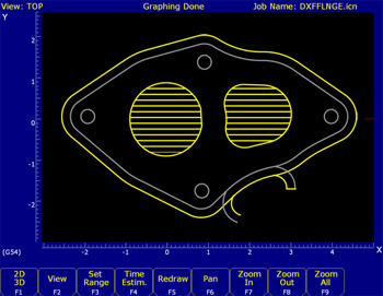

    Automatic tool path selection, contouring and pocketing with repeat to depth and finish passes.
    Step #2

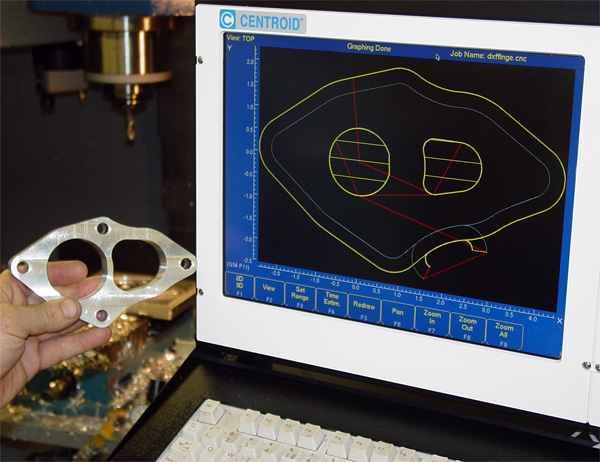

    Using the mouse and the keyboard select the parts of the CAD file you want to machine, select the type of machining to be done, change the part zero point, add in cuter comp (if necessary) and the tool path is created automatically.
    View graphics of your work at any time, easily go back and make changes to any part of your work. Graphics show both porgrammed path the the cutter compensated path.

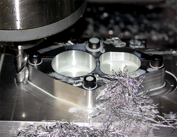

    Set up your vise or fixture and machine the part.
    With a CENTROID CNC control you can stop the job at any point for any reason and resume right where you left off. The control automatically keeps track of where it was machining when stopped and will start right back up at the begining of that line or arc OR where ever you want.
    Here you see the final finish pass on our Turbo Flange adapter, we had Intercon automatically create several passes of the outside contour to reach the final depth, then the finish pass is made at full depth for the best possible surface finish.
