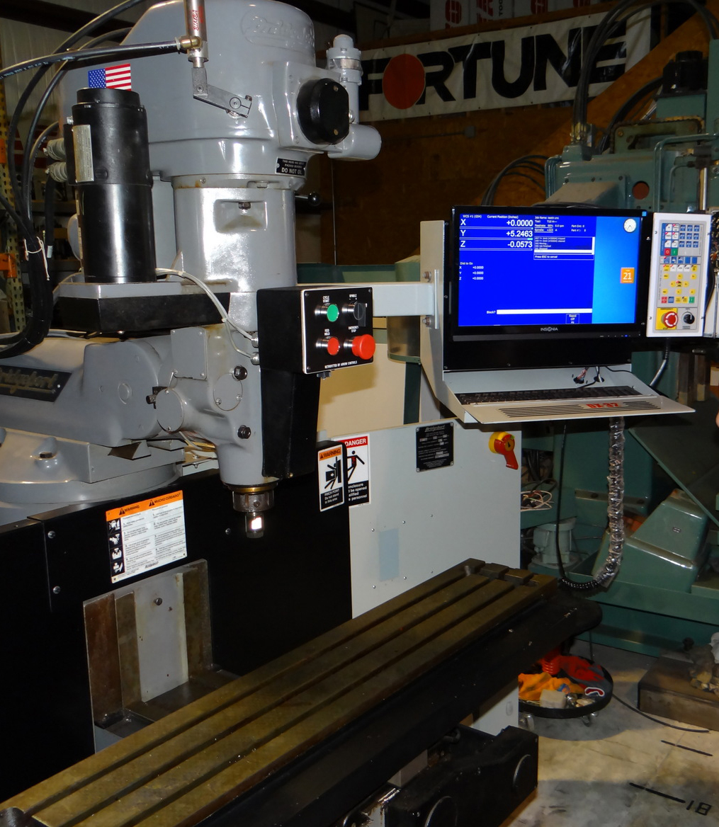

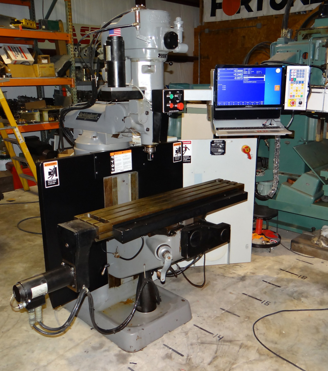

"After"..M39 CNC control upgrade and ready to make parts!
Bridgeport V2XT DX-32 after CNC upgrade
In addition to all the great CNC features that you get with the CENTROID, After the retrofit, the Bridgeport V2XT / DX-32 will be faster, more accurate, quieter and is easier to program and operate.. This machine was upgraded in 14 hrs reusing the existing original DC Servos motors (with an encoder upgrade, click here for more information). With a CENTROID retrofit upgrade kit, you will be up and cutting parts, making money in a matter of days. This machine used the Centroid Bridgeport M39 DIY CNC control upgrade package that utilizes the Centroid Allin1DC CNC control board.

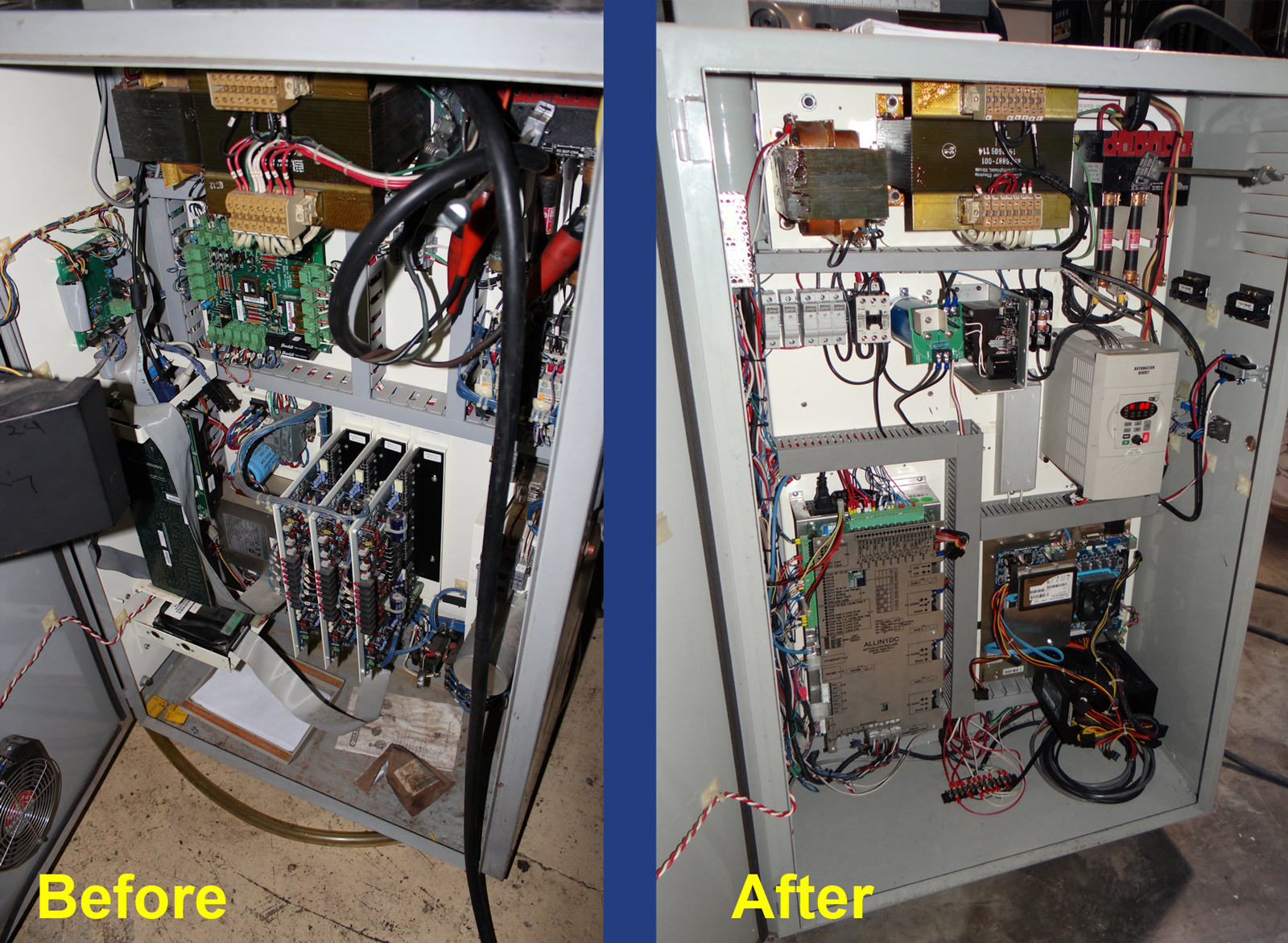

Bridgeport CNC electrical cabinet before and after CNC upgrade
The Centroid Allin1DC CNC control board can be seen in the lower left of the "After" image above along with the new CNCPC in the lower right and a new VFD for programmable spindle speed control of the spindle motor. The original Disconnect and Transformers were reused, while a new Centroid Cap Board Combo replaced the old Bridge rectifier and a few new circuit breakers were used to replace the old fuse blocks. The Allin1DC has 9 relay outputs built into the CNC control board and they were used to control the existing Lube Pump, Mister and Work light which eliminated the old relays.
The stock servo motors are retained and even the stock servo cables can be reused (if they are in good condition). The stock SEM DC servo motors are upgraded with a modern encoder to be compatible with the Allin1DC CNC control board. the Stock operators control console is modified and reused. A touch screen LCD is placed where the old CRT would go and the mounting bracket for the Centroid CNC operators pendant is bolted to the stock DX-32 console. This customer also chose to upgrade the operator control buttons on the Head of the machine (which are duplicated on the Pendant as well).

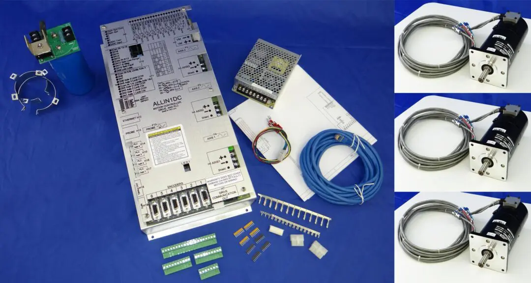

Centroid Bolt-on replacement DC servo motors are available for the case where an original motor is missing or damaged.
Now this machine is more capable than ever with many standard CNC features that go way above and beyond the original DX-32 capabilities. The Centroid also offers optional CNC accessories such as Automatic Tool Height Measurement and Part Probing System that save time and bring new functionality to the machine tool.
Bridgeport V2XT with DX-32 control CNC Retrofit Upgrade using many stock components and Centroid M39 CNC control upgrade kit. The M-39 is modern Windows 10 (Windows 7 or 8 is also compatible) CNC controller which brings this machine back to life with easy programming and operation.

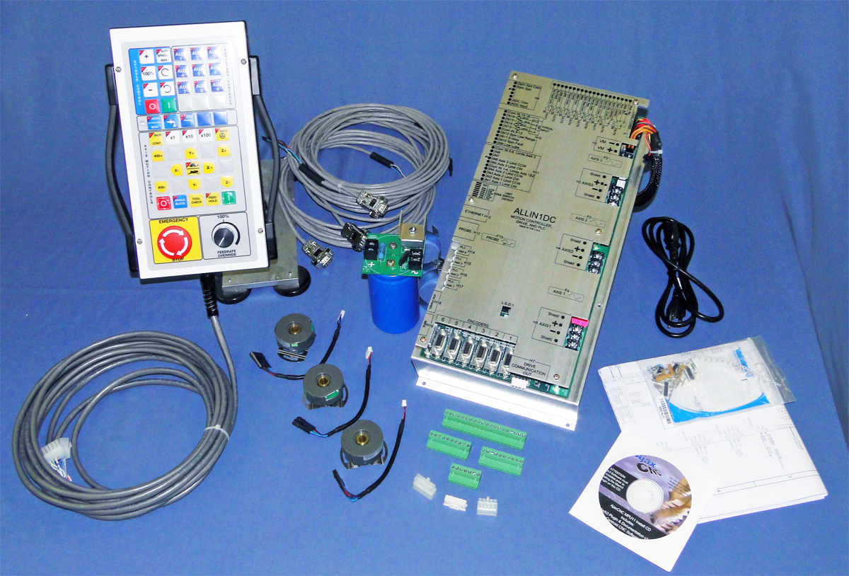

Bridgeport Boss 8-12 / V2XT / V2ES / EZ Trak, Heidenhain TNC 145 Interact I or II Knee Mill CNC Kit
For these controls, you can reuse your existing servomotors and save money. Use the existing encoders (must accept differential Quadrature signals) or simply replace the low-resolution encoders with our 10,000 line units and dramatically increase the performance, and accuracy of your machine. See slide show below.
These Bridgeport's were originally equipped with servo motors which (if in good shape) can be reused at significant savings.
Kit includes:
– ALLIN1DC (Motion Control, PLC, DC Drives) with connector kit
– Machine Control Pendant, plug and play with Allin1DC
– Qty. 3 10,000 Line Encoders
– Qty. 3 Pre-Wired Encoder Cables
– Capacitor and Bridge combo board
– Centroid Mill CNC Software with Intercon Conversational programming software
-  Easy to follow Full Sized printed wiring schematic
